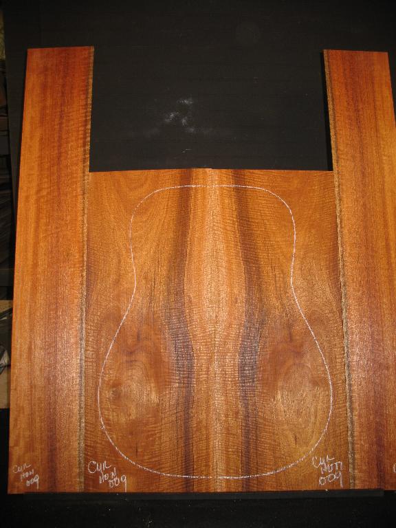

PostPosted: Tue Jun 12, 2007 4:22 pm
Posts: 830
Hi Mr C,
John Elshaw posted this picture on the OLF forum.
It's a picture of a highly figured Mahogany.
He mentioned that he obtained a couple of sets from you...Do you have anything similar...?
I always mis out on the really exotin stuff.
